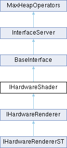

Inheritance diagram for IHardwareShader:
