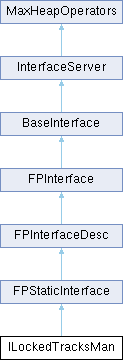

Inheritance diagram for ILockedTracksMan:
