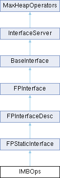

IMBOps Class Referenceabstract
The interface for Image Motion Blur. More...
#include <C:/adskgit/3dsmax/3dsmax/3dswin/src/maxsdk/include/imblur.h>
Inheritance diagram for IMBOps:
