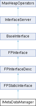

Inheritance diagram for IMetaDataManager:
