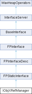

Inheritance diagram for IObjXRefManager:
