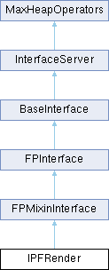

IPFRender Class Referenceabstract
#include <C:/adskgit/3dsmax/3dsmax/3dswin/src/maxsdk/include/ParticleFlow/IPFRender.h>
Inheritance diagram for IPFRender:
