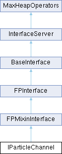

Inheritance diagram for IParticleChannel:
