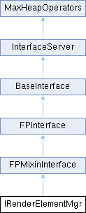

Inheritance diagram for IRenderElementMgr:
