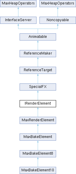

Inheritance diagram for IRenderElement:

Class SpecialFX, Class PBBitmap, Class ISave, Class ILoad, Reference Messages, ~{ Render Elements }~
Description:
This is the interface that must be supported by all render elements whether they support the 3ds Max renderer or some other renderer. The UI in the render dialog uses this interface exclusively to control the element.
The methods are almost all state-setting methods, with ones that are settable by the UI provided by both sets and gets. A sample plugin of a Render Element can be found in the SDK samples; /MAXSDK/SAMPLES/RENDER/RENDERELEMENTS.
Member Function Documentation
◆ SetEnabled()
virtual void SetEnabled ( BOOL enabled)
pure virtual
Remarks
This method enables or disables the Render Element.
Parameters:
