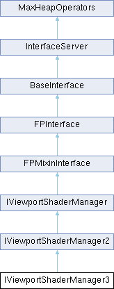

Inheritance diagram for IViewportShaderManager3:
