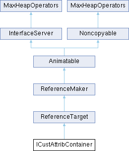

Inheritance diagram for ICustAttribContainer:
