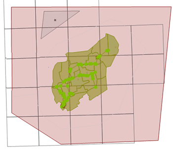

  2. On the GeoPlan, create a new polygon (TVD connector) object, which covers the area for which the simulation is to be run. The polygon can exist outside of the network but must be within the spatial rainfall area (the gridded, radar cell boundaries area) as shown in the following example:
    Example of Gridded Area
    If the existing network contains a spatial rain zone, then the polygon (TVD connector) being created must be enclosed by a spatial rain zone (either the original spatial rain zone or a new one). A spatial rain zone is used to define where the rainfall calculations take place – if there is a spatial TSD with a large area of gridded rainfall then the calculations may take a long time. The spatial rain zone can be used to narrow the calculations down to only the area you are interested in. If there is not a spatial rain zone then the whole of the spatial rainfall is used. If there is a spatial rain zone then only that area of spatial rainfall is used. If your TVD connector falls out of this area, then you need another spatial rain zone to make sure that it can use the spatial rainfall.

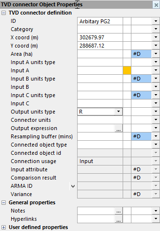

    The object properties sheet, for the newly created TVD connector, is automatically displayed on the left part of the main window. The ID, X coord, Y coord and Area fields are automatically filled-in, and the Connection usage is automatically set to Input (default).
  4. Ensure that the Output units type field in the TVD connector's properties is set to R (rainfall intensity). No other properties should be specified.
    TVD Connector Properties Example for Averaged Spatial Rainfall
