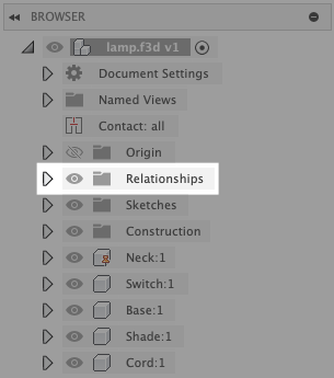

When you create a new relationship between components, it appears in the Browser > Relationships folder.
assembly relationships folder in browser

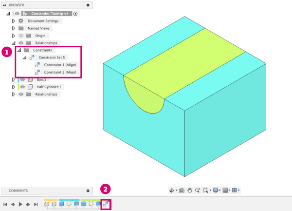

Constraint access points
There are 2 access points where you can interact with assembly constraints:
access points for constraints
  1. In the Browser, within the Relationships > Constraints folder.
  2. In the Timeline.
