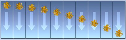

The Gravity space warp simulates the effect of natural gravity on particles generated by a particle system. Gravity is directional. Particles moving in the direction of the gravity arrow accelerate. Particles moving against the arrow decelerate.
Particles falling because of gravity
In the case of spherical gravity, motion is toward the icon.
Gravity effect on snow
