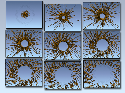

Motor disperses a cloud of particles
Motor viewport icon (with particle system on the left)
