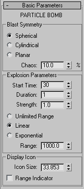

Blast Symmetry group
These options specify the shape, or pattern of the blast effect.
  • Spherical (The default) The blast force radiates outward from the PBomb icon in all directions. The icon looks like a spherical anarchist's bomb.
  • Cylindrical The blast force radiates outward from and normal to the central axis, or core of the cylindrical icon. The icon looks like a stick of dynamite with a fuse.
  • Planar The blast force radiates both up and down, perpendicular to the plane of the planar icon. The icon looks like a plane with arrows pointing up and down along the direction of the blast force.
Chaos
The blast forces vary for each particle or each frame, an effect similar to Brownian motion, with a rate of change in the direction of force equal to the rendering interval rate. Note: This setting is effective only when the Duration spinner is set to 0.
Explosion Parameters group
Start Time
The frame number at which the impulse forces are first applied to the particles.
Duration
The number of frames, beyond the first, over which the forces are applied. This value should typically be a small number, such as between 0 and 3.
Strength
The change in velocity along the blast vector, in units per frame. Increasing Strength increases the speed with which the particles are blown away from the bomb icon.
  • Unlimited Range The effects of the bomb icon reach all bound particles throughout the scene. This option ignores the Range setting (which specifies the distance of the PBomb effect).
  • Linear The impulse forces decay linearly between the full Strength setting to a value of 0 at the specified Range setting.
  • Exponential The impulse forces decay exponentially between the full Strength setting to a value of 0 at the specified Range setting.
    Range The maximum distance, in units, over which the PBomb icon affects the bound particle system. If the Range is large enough to reach only a portion of the particle system, only that part of the system is affected.
    If you turn on Range Indicator (see following), the extent of the range is indicated by a tri-hooped sphere. If you choose Unlimited Range, this parameter has no effect.
Display Icon group
These options affect the visual display of the PBomb icon.
Icon Size
Alters the overall size of the PBomb icon.
Range Indicator
Displays a wireframe sphere that indicates the volume of the particle bomb's influence. If you choose Unlimited Range, turning this on has no effect.
