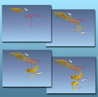

The Vortex space warp applies a force to particle systems, spinning them through a whirling vortex, and then moving them down a long, thin spout or vortex well. Vortex is useful for creating black holes, whirlpools, tornadoes, and other funnel-like objects.

The space warp settings let you control the vortex shape, the well characteristics, and rate and range of particle capture. The shape of the vortex is also affected by particle system settings, such as speed.
Particle stream caught in a vortex

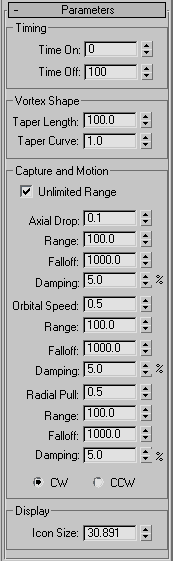

Timing group
Time On/Time Off
The frame numbers at which the space warp becomes active and becomes inactive.
Vortex Shape group
Taper Length
Controls the length of the vortex, as well as its shape. Lower settings give you a "tighter" vortex, while higher settings give you a "looser" vortex. Default=100.0.
Taper Curve
Controls the shape of the vortex. Low values create a vortex with a wide, flared mouth, while high values create a vortex with nearly vertical sides. Default=1.0. Range=1.0 to 4.0.
Capture and Motion group
This group contains basic settings for Axial Drop, Orbital Speed, and Radial Pull, with Range, Falloff, and Damping modifiers for each.
Unlimited Range
When on, Vortex exerts full damping strength over an unlimited range. When off, the Range and Falloff settings take effect.
Axial Drop
Specifies how quickly particles move in the direction of the drop axis.
Range
The distance from the center of the Vortex icon, in system units, at which Axial Damping has its full effect. Takes effect only when Unlimited Range is turned off.
Falloff
Specifies the distance beyond the Axial Range within which Axial Damping is applied. Axial Damping is strongest at the Range distance, decreases linearly out to the limit of the Axial Falloff, and has no effect beyond that. Takes effect only when Unlimited Range is turned off.
Damping
Controls the degree to which particle motion parallel to the drop axis is restrained per frame. Default=5.0. Range=0 to 100.
For subtle effects, use values of less than 10%. For more overt effects, try using higher values that increase to 100% over the course of a few frames.
Orbital Speed
Specifies how quickly the particles rotate.
Range
The distance from the center of the Vortex icon, in system units, at which Orbital Damping has its full effect. Takes effect only when Unlimited Range is turned off.
Falloff
Specifies the distance beyond the Orbital Range within which Orbital Damping is applied. Orbital Damping is strongest at the Range distance, decreases linearly out to the limit of the Orbital Falloff, and has no effect beyond that. Takes effect only when Unlimited Range is turned off.
Damping
Controls the degree to which orbital particle motion is restrained per frame. Smaller values produce a wide spiral, while larger values produce a thin spiral. Default=5.0. Range=0 to 100.
Radial Pull
Specifies the distance from the drop axis at which the particles rotate.
Range
The distance from the center of the Vortex icon, in system units, at which Radial Damping has its full effect. Takes effect only when Unlimited Range is turned off.
Falloff
Specifies the distance beyond the Radial Range within which Radial Damping is applied. Radial Damping is strongest at the Range distance, decreases linearly out to the limit of the Radial Falloff, and has no effect beyond that. Takes effect only when Unlimited Range is turned off.
Damping
Controls the degree to which Radial Pull is restrained per frame. Default=5.0. Range=0 to 100.
CW/CCW
Determines whether particles rotate clockwise or counterclockwise.
Display group
Icon Size
Specifies the size of the icon.
