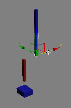

Example: To use the Hierarchy panel settings:
Select the green bone and move it on the X axis. It moves as you might expect, based on standard rules of transforming hierarchy members.
Undo any changes from step 1. - To lock the bone, go to the
Hierarchy panel, click Link Info, and then in the Bone Hierarchy rollout
SetupMode group, turn on Lock Local Position. Now, when you try to move the bone, nothing happens, because the position is locked.

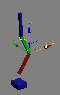

- On the Hierarchy panel, turn on Manipulation Affects Neighbors In Hierarchy.
Now, when you move the green bone, its local position doesn't change, but it rotates its parent (the red bone), and also rotates itself to look at its child (the blue bone).
Select the red bone, and in the Setup Mode group, turn on Manipulation Causes Stretching. Now, when you move the green bone the red bone stretches to reach the position of the green bone.
Select the green bone, and in the Setup Mode group, turn on Manipulation Causes Stretching. Now, when you move the green bone, both the red and green bones stretch to reach the position of the green bone.
This example uses a simple hierarchy of three Extra Bones, as shown following:

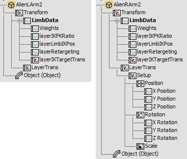

By default, CATBones use a static transform value called SetupTM, which is not visible in the animation editor (because it can't be animated), and is accessible only via MAXScript.
The idea of the setup pose is that it cannot be animated, so no setup animation controller is available by default. When you choose the Animation Controller option, you get a Setup animation controller, as a child of the LayerTrans (Layer Transform) track, that you can view and edit in Track View.
Track View hierarchy of CATbone with Setup Mode set to:
Left: Static Matrix Value
Right: Animation Controller
The reason you might want an animation controller in setup mode is to take advantage of the feature Additive to Setup Pose. You can apply your own procedural animation controller setup to the setup controller, and then make the layer system relative to that controller.
