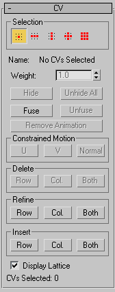

Interface
In addition to the CV rollout described here, the Surface CV sub-object level also displays the Soft Selection rollout.
CV rollout
Surface CV sub-object rollout
Selection group
Surface CV sub-object selection controls
Single CV -
(The default.) When on, you can select individual CVs by clicking, or groups of CVs by dragging a region.
Row of CVs -
When on, clicking a CV selects the entire row the CV belongs to. Dragging selects all rows in the region.
Column of CVs -
When on, clicking a CV selects the entire column the CV belongs to. Dragging selects all columns in the region.
Row and Column of CVs -
When on, clicking a CV selects both the row and column the CV belongs to. Dragging selects all rows and columns in the region.
All CVs -
When on, clicking or dragging selects all the CVs in the surface.
- Name
Shows either "No CVs selected", "Multiple CVs selected", or "SurfaceName(uIndex,vIndex)", where "SurfaceName" is the name of the CV's parent surface, and "uIndex,vIndex" is the CV's UV location on the surface. You can't edit the Name field to customize the names of CVs.
If CVs are fused, the Name field shows the name of the first CV.
- Weight
Adjusts the weight of the selected CVs. You can use a CV's weight to adjust the CV's effect on the surface. Increasing the weight pulls the surface toward the CV. Decreasing the weight relaxes the surface away from the CV.
Increasing weight is a way to harden a surface: that is, to sharpen its curvature at a particular location.
By default, the weight is 1.0 for the CVs of NURBS objects that you create on the Create panel or the NURBS sub-object creation rollouts. The weight of CVs in geometry that you convert to NURBS can vary, depending on the object's original shape.
You can change the weight when multiple CVs are selected. Using the Weight field or spinner while multiple CVs are selected assigns all of them the value you choose. Because weights are relative to each other (rational), using the Weight control when all CVs are selected has no visible effect.
Tip: You can increase the curvature of an indentation in a surface by increasing the weight of the CVs surrounding the indented area. This is easier and often more effective than moving the indented area's CVs. - Hide
Click to hide the currently selected CVs.
- Unhide All
Click to unhide all hidden CVs.
- Fuse
Fuses a CV to another CV. (You can't fuse a CV to a point, or vice versa.) This is one way to connect two surfaces. It is also a way to change the shape of surfaces.
Fusing CVs does not combine the two CV sub-objects. They are connected but remain distinct sub-objects that you can unfuse later.
Fused CVs behave as a single CV until you unfuse them. Fused CVs behave similar to a single point, but the property of multiplicity for coincident CVs also applies. (See NURBS Concepts and CV Curve.) The fused CVs have proportionally more influence on the curve, which can become sharper in the fused CVs' vicinity, or even angular if more than two CVs are fused together.
Fused CVs are displayed in a distinct color. The default is purple. (You can change this color using the Colors panel of the Customize User Interface dialog.)
- Unfuse
Unfuses the fused CVs.
- Remove Animation
Removes animation controllers from the selected CVs.
Constrained Motion group
These buttons constrain CV motion. They are enabled when you select one or more CVs. When you finish dragging the CV selection, the active constraint button turns off.
- U
Constrains the CV selection to move in the surface's U dimension.
Keyboard shortcut (Keyboard Shortcut Override Toggle must be on): Alt+U
- V
Constrains the CV selection to move in the surface's V dimension.
Keyboard shortcut (Keyboard Shortcut Override Toggle must be on): Alt+V
- Normal
Constrains the CV selection to move normal to the original surface.
Keyboard shortcut (Keyboard Shortcut Override Toggle must be on): Alt+N
Delete group
These buttons delete CVs from the surface. Select one or more CVs, and then click Row, Col., or Both.
You can't delete surface CVs if the deletion would give the surface fewer than four rows or fewer than four columns. Aside from that restriction, these buttons delete all rows, columns, or rows and columns that contain selected CVs. This means that you can't delete after you make a selection using the Row and Column or All selection buttons: that would imply deleting the entire CV surface.
These buttons are unavailable unless the deletion is possible.
- Row
Deletes rows of CVs from the surface.
- Col.
Deletes columns of CVs from the surface.
- Both
Deletes both rows and columns of CVs from the surface.
Refine group
These buttons refine the surface by adding CVs. As you move the mouse over the surface, a preview of the CVs that will be added, and their locations, is displayed in blue.
- Row
Adds a row of CVs to the surface.
- Col.
Adds a column of CVs to the surface.
- Both
Adds both a row and a column of CVs to the surface.
Tip: It is a good idea to reparameterize after you have added CVs to a surface by refining. See Editing Surface Sub-Objects.
Insert group
These buttons insert CVs into the curve. Click to turn on one of these buttons and then click the surface where you want to insert the new CVs. Inserting CVs is similar to refining with CVs, except that other CVs in the surface do not move. This means that the shape of the surface can change when you insert.
Inserting CVs does not remove animation from the surface the way refining does.
- Row
Inserts a row of CVs into the surface.
- Col.
Inserts a column of CVs into the surface.
- Both
Inserts both a row and a column of CVs into the surface.
Tip: It is a good idea to reparameterize after you have added CVs to a surface by inserting. See Editing Surface Sub-Objects.
- Display Lattice
When on, displays the control lattice that surrounds CV surfaces. When off, the control lattice isn't shown in viewports. Default=on.
- CVs Selected
This text field shows how many CVs are currently selected.
