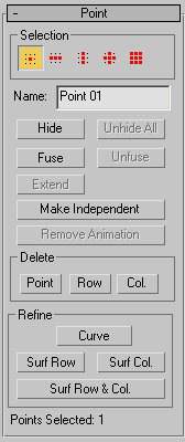

Interface
In addition to the Point rollout described here, the Point sub-object level also displays the Soft Selection rollout.
Selection group
Point sub-object selection controls
Single Point
(The default.) When on, you can select individual points by clicking, or groups of points by dragging a region.
Row of Points
When on, clicking a point selects the entire row the point belongs to. Dragging selects all rows in the region.
If the point is on a curve, Row of Points selects all points in the curve.
Column of Points
When on, clicking a point selects the entire column the point belongs to. Dragging selects all columns in the region.
If the point is on a curve, Column of Points selects only a single point.
Row and Column of Points
When on, clicking a point selects both the row and column the point belongs to. Dragging selects all rows and columns in the region.
All Points
When on, clicking or dragging selects all the points in the curve or surface.
Tip: Rows and columns are easily visible when the NURBS surface is planar, or nearly so. When the surface has a complicated curvature, rows and columns can be more difficult to see. The Row, Column, and Row/Column buttons can be especially useful in this situation.
Name
Shows the name of the currently selected point. It is disabled if you have selected multiple points.
By default, the name is "Point" followed by a sequence number. You can use this field to give the point a name that you choose.
Hide
Click to hide the currently selected points.
Unhide All
Click to unhide all hidden points.
Fuse
Fuses a point to another point. (You can't fuse a CV to a point, or vice versa.) This is one way to connect two curves or surfaces. It is also a way to change the shape of curves and surfaces.
Fusing points does not combine the two point sub-objects. They are connected but remain distinct sub-objects that you can unfuse later.
Fused points behave as a single point until you unfuse them.
Fused points are displayed in a distinct color. The default is purple. (You can change this color using the Colors panel of the Customize User Interface dialog.)
Unfuse
Unfuses the fused points.
Extend
Extends a point curve. Drag from the end of a curve to add a new point and extend the curve.
Warning: When you add points with Extend, you lose the animation controllers for all points on the curve or surface.
Make Independent
Disabled if the point is independent. If the point is dependent, clicking this button makes it independent.
Warning: When you make a point independent, you lose the animation controllers for all objects that depend on it in turn.
Remove Animation
Removes animation controllers from the selected points.
Delete group
The buttons in this group delete one or more points.
Point
Deletes a single point (on a curve) or a row and column of points (on a surface).
Row
Deletes a row from a surface.
Col.
Deletes a column from a surface.
Warning: When you delete points, you lose the animation controllers for all points on the curve or surface.
Refine group
The buttons in this group refine point curves or surfaces by adding points to them.
Curve
Adds points to a point curve.
Surf Row
Adds a row of points to a point surface.
Surf Col.
Adds a column of points to a point surface.
Surf Row & Col.
Adds both a row and a column to a point surface; their intersection is where you click the surface.
Warning: When you add points, you lose the animation controllers for all points on the curve or surface.
Points Selected
This text field shows how many points are currently selected.
