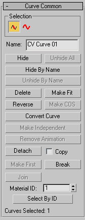

Interface
Curve Common rollout
The controls on this rollout apply to all curve types. Depending on the type of curve, an additional rollout is displayed with controls specific to that type of curve.
Selection group
The selection buttons for curve sub-objects let you select either individual curves, or curves that are connected in space.
Curve sub-object selection controls
Single Curve -
Clicking or transforming a curve selects only a single independent curve sub-object.
All Connected Curves -
Clicking or transforming a curve selects all curve sub-objects that are connected within the NURBS object. To be connected, two curves must have fused points, or one curve must be a connected dependent (a blend, fillet, or chamfer) of the other.
- Name
Shows the name of the currently selected curve. It is disabled if you have selected multiple curves.
By default, the name is the name of the curve type ("CV Curve" or "Point Curve") followed by a sequence number. You can use this field to give the curve a name that you choose.
- Hide
Click to hide the currently selected curves.
- Unhide All
Click to unhide all hidden curves.
- Hide by Name
Click to display a Select Sub-Objects dialog that lists curves by name. Select the curves to hide, then click Hide.
- Unhide by Name
Disabled unless there are hidden curves. Click to display a Select Sub-Objects dialog that lists curves by name. Select the curves to make visible, then click Unhide.
- Delete
Deletes the selected curve sub-objects.
- Make Fit
Turns a CV curve into a point curve. This displays the Make Point Curve dialog, which lets you set the number of points.
For a point curve, this button lets you change the number of points in the curve.
- Reverse
Reverses the order of the CVs or points in a curve, so that the first vertex becomes the last, and the last becomes the first.
The first point or CV is significant when you use the NURBS curve like a spline: as a loft path or shape, as a path constraint path, or as a motion trajectory. For these purposes, the first vertex of the curve is significant. If the curve is a closed curve, you can use Make First to set the curve's first vertex.
The direction of the curve also determines the initial direction of normals on surfaces based on this curve.
- Make COS
This button is enabled only for the following kinds of curves:
- U iso curves
- V iso curves
- Normal projected curves
- Vector projected curves
- Surface-surface intersection curves
- Surface edge curves
- CV curves on surfaces
Point curves on surfaces
This displays a Make Curve on Surface dialog, which turns the selected curve into a CV or point curve on surface. Once converted, you can edit the new curve on surface using the curve on surface controls, including the Edit Curve on Surface dialog.
If the curve is already a curve on surface, this button lets you change it from a point to CV curve on surface, or vice versa.
The new Curve on Surface preserves the trimming of the original curve.
- Convert Curve
Click to display the Convert Curve dialog. This dialog provides a more general way to convert a CV curve to a point curve, or a point curve to a CV curve. It also lets you adjust a number of other curve parameters.
- Make Independent
Disabled if the curve is independent. If the curve is dependent, clicking this button makes it independent.
Warning: When you make a curve independent, you lose the animation controllers for all objects that depend on it in turn. If you make a curve that trims a surface independent, you lose the trimming of the surface. - Remove Animation
Removes animation controllers from the selected curves.
- Detach
Detaches the selected curve sub-object from the NURBS model, making it a new top-level NURBS curve object. The Detach dialog is displayed, which lets you name the new curve. The new object is no longer part of the original NURBS model.
To create a new top-level NURBS curve that is a copy of the selected curve, turn on Copy before you click Detach.
- Copy
When on, clicking Detach creates a copy of the selected curve instead of detaching it from the NURBS model. Default=off.
- Make First
For a closed curve, lets you choose a position that becomes the first vertex of the curve.
- Break
Breaks a single curve into two curves. Click in a viewport to choose the location to break the curve.
Warning: When you break a curve sub-object, you lose the animation controllers for all points or CVs on the curve. - Join
Joins two curve sub-objects together. After you have joined the curves in a viewport, the Join Curves dialog is displayed. This dialog lets you choose the method for joining the two curves.
Warning: When you join two curve sub-objects, you lose the animation controllers for all points or CVs on both curves. - Material ID
Lets you assign a material ID value to the curve. If the curve is renderable, material IDs let you assign a material to the curve using a Multi/Sub-Object material. In addition, the Select by ID button lets you select a curve or multiple curves by specifying a material ID number. Can range from 1 to 100. Default=1.
- Select by ID
Displays a Select by Material ID dialog.
