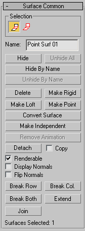

Interface
Surface Common rollout
Surface sub-object rollout
The controls on this rollout apply to all surface types. Depending on the type of surface, an additional rollout is displayed with controls specific to that type of surface.
Selection group
The selection buttons for surface sub-objects let you select either individual surfaces, or surfaces that are connected in space.
Surface sub-object selection controls
Single Surface -
Clicking or transforming a surface selects only a single surface sub-object.
All Connected Surfaces -
Clicking or transforming a surface selects all surface sub-objects that are connected within the NURBS object. To be connected, two surfaces must have all the CVs on a shared edge fused between them, or one surface must be a connected dependent of the other (for example, a blend or a cap).
- Name
Shows the name of the currently selected surface. It is disabled if you have selected multiple surfaces.
By default, the name is the name of the surface type ("CV Surface," "Point Surface," "Blend Surface," and so on) followed by a sequence number. You can use this field to give the surface a name that you choose.
- Hide
Click to hide the currently selected surface.
- Unhide All
Click to unhide all hidden surfaces.
- Hide by Name
Click to display a Select Sub-Objects dialog that lists surfaces by name. Select the surfaces to hide, then click Hide.
- Unhide by Name
Disabled unless there are hidden surfaces. Click to display a Select Sub-Objects dialog that lists surfaces by name. Select the surfaces to make visible, then click Unhide.
- Delete
Deletes the selected surface sub-objects.
- Make Rigid
Makes the surface rigid. The only editing allowed on a rigid surface is to transform it at the Surface sub-object level. You can't move a rigid surface's points or CVs, or change the number of points or CVs.
Rigid surfaces reduce the amount of memory used by the NURBS model. Making surfaces rigid improves performance, especially for large and complex models.
When a surface is rigid, you can't see its points or CVs when you are at the Point or Surface CV sub-object levels. If the model has no nonrigid surfaces and no point curves, the Point and Surface CV sub-object levels aren't available at all.
To make a surface no longer rigid, click Make Point or Make Independent. Editing the surface with Break, Join, and so on also makes it no longer rigid.
- Make Loft
Displays a Make Loft dialog to convert the surface sub-object to a (dependent) U loft or UV loft surface. Can also change the dimension used to construct a U loft surface.
You can’t use Make Loft if the surface sub-object is in an error condition.
Tip: Make Loft creates a loft with uniformly spaced curves. To make a loft with adaptively spaced iso curves, manually create the curves and then loft them with U Iso Lines, V Iso Lines, or U and V Iso Lines. - Make Point
Displays a Make Point dialog to convert any kind of surface to a point surface. You can also use Make Point to change the number of rows and columns if the surface is already a point surface.
- Convert Surface
Click to display the Convert Surface dialog. This dialog provides a general way to convert a surface to a different type of surface. You can convert between lofts, point ("fit") surfaces, and CV surfaces. The dialog also lets you adjust a number of other surface parameters.
- Make Independent
Disabled if the surface is independent. If the surface is dependent, clicking this button makes it independent.
Warning: When you make a surface independent, you lose the animation controllers for all objects that depend on it in turn. - Remove Animation
Removes animation controllers from the selected surfaces.
- Detach
Detaches the selected surface sub-object from the NURBS model, making it a new top-level NURBS surface object. The Detach dialog is displayed, which lets you name the new surface. The new object is no longer part of the original NURBS model.
To create a new top-level NURBS surface that is a copy of the selected surface, turn on Copy before you click Detach.
- Copy
When on, clicking Detach creates a copy of the selected surface instead of detaching it from the NURBS model. Default=off.
- Renderable
When on, the surface renders. Turn off to make the surface invisible in renderings. Default=on.
- Display Normals
When on, the normal for each selected surface is displayed. There is one normal per surface sub-object. The normal is displayed at the surface's UV origin, so displaying normals can help you see how materials will be mapped. On the other hand, the normal can be hard to see if you are zoomed out. Default=off.
- Flip Normals
Turn on to reverse the direction of the surface normals. Default=off.
Tip: The Flip Normals control is useful for viewing a surface that is mostly concave or mostly convex. With more complicated NURBS surfaces, you often want to render both sides of the surface. To see both sides of the surface, turn on Force 2-Sided on the Render Setup dialog. To see both sides of the surfaces in viewports, turn on Force 2-Sided on the Rendering Method panel of the Viewport Configuration dialog, or assign a Double-Sided Material. - Break Row
Breaks the surface into two surfaces in the direction of a row (the surface's U axis).
- Break Col.
Breaks the surface into two surfaces in the direction of a column (the surface's V axis).
- Break Both
Breaks the surface into four surfaces in both directions.
You cannot break a trimmed surface.
- Extend
Extends the surface by changing its length.
Warning: Extending a surface loses all animation controllers for the surface and its points or CVs. - Join
Joins two surface sub-objects together. After you have joined the surfaces in a viewport, the Join Surfaces dialog is displayed. This dialog lets you choose the method for joining the two surfaces. You can join only original edges of surfaces; you cannot join edges created by trimming.
Warning: When you join two surface sub-objects, you lose the animation controllers for all point or CVs on both surfaces.
