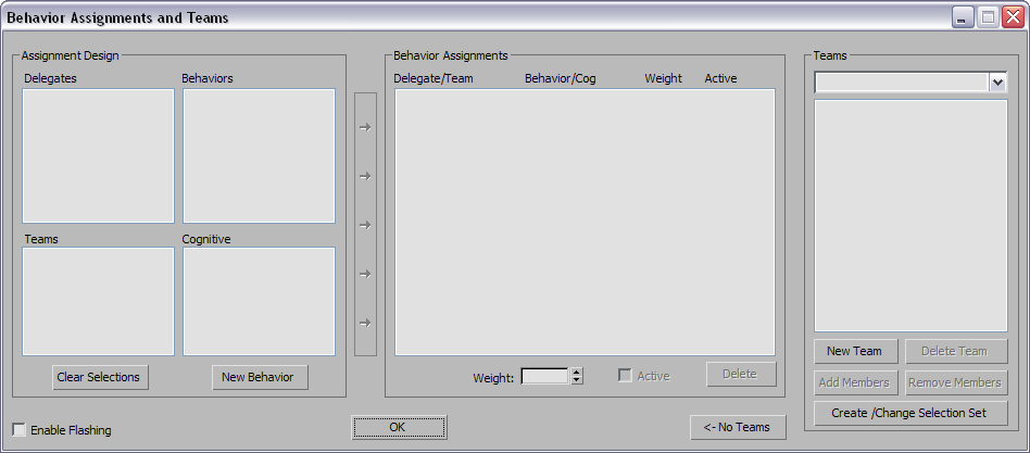

The Behavior Assignments and Teams dialog lets you group delegates into teams, and assign behaviors and cognitive controllers to individual delegates and teams. It also lets you modify existing assignments.
The dialog is modeless; while it's open, you can use the Modify panel to adjust behaviors and set up new behaviors, as well as animate assignments' Weight settings.
- Click a delegate or team in the Assignment Design group
- Click an assignment in the Behavior Assignments group
- Add members to a team in the Teams group
- Remove members from a team in the Teams group

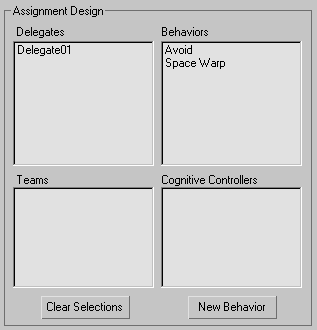

Lets you set up assignments by choosing a behavior or cognitive controller and a delegate or team to assign it to. Choose one item from the left side (upper or lower list), and one item from right side (upper or lower list). Then click the New/Reset Assignment button immediately to the right of the Assignment Design group (vertical button with five right-pointing arrows).
You can select multiple behaviors for a new assignment to a delegate or team. When you click New Assignment, character studio creates a separate assignment for each highlighted behavior. For changing assignments, you're still restricted to choosing one behavior at a time. If you choose an existing assignment and multiple behaviors, the Reset Assignment button becomes unavailable.
- Delegates list
- Lists delegates in the scene.
- Behaviors list
- Lists existing behaviors.
To use a behavior that hasn't been added to the scene yet, click the New Behavior button at the bottom of this group.
- Teams list
- Lists teams in the scene.
To create a new team, use the controls in Teams group box.
- Cognitive Controllers list
- Lists existing cognitive controllers.
To create a new controller, click the Setup rollout
Cognitive Controllers button. You needn't first exit the Behavior Assignments and Teams dialog; when you close the editor, the new controllers are added to the Cognitive Controllers list. - Clear Selections
- Deselects all highlighted items in the Assignment Design and Behavior Assignments groups.
Use this before modifying an assignment, to avoid possible confusion.
- New Behavior
- Opens the Select Behavior Type dialog, which lets you add a behavior to the scene for use in an assignment.
To modify a new behavior, use the facilities available in the Crowd object's rollouts.
Note: If you add the first behavior in the scene from this dialog, the text box in the Crowd object
Setup rollout remains empty, and no rollout for the behavior appears. To edit the behavior, choose it from the list.

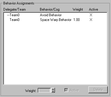

Lets you create and modify behavior assignments.
- [behavior assignment list]
- Displays all current behavior assignments, including team or delegate name, assigned behavior or cognitive controller, weight setting, and active status.
Items are sorted in alphabetical first by Delegate/Team name, and then by Behavior/Cog name. A dashed line appears before a list entry if it's the first item for that delegate or team.
To modify or delete an assignment, choose it from the list, whereupon character studio highlights the assigned components in the Assignment Design group. Make the changes using the remaining controls in this dialog.
Note: You can select multiple assignments from the list by Ctrl+clicking for non-contiguous items or Shift+clicking for contiguous items. To clear an item, Ctrl+click it. - Weight
- The relative effect of the assigned behavior or cognitive controller. The higher an assignment's Weight setting is than others', the greater relative effect it will have. This setting is animatable. Default=1.0.
In most cases, you should keep Weight within a range of 0.0 to 1.0. Higher settings are available but shouldn't be used unless absolutely necessary.
Note: The Weight setting does not apply to the Avoid, Orientation, or the Surface Follow behavior, and is thus unavailable for assignments using any of those three. - Active
- When on, the assignment is currently in effect. When off, the assignment has no effect. This checkbox is animatable. Default=on.
- Delete
- Deletes the highlighted behavior assignment.

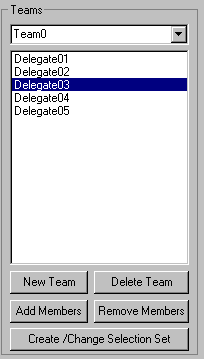

Teams group
Lets you define, modify, and delete teams of delegates.
- [teams drop-down list]
- Displays the name of the current team.
To view a different team, choose it from the list. To change a team name, click in the box and then use the keyboard to edit the text.
- [delegates list]
- Displays delegates in the current team.
- New Team
- Adds a team to the list, and opens the Select Delegates dialog to let you specify new team members.
The default team name is "Team," followed by a number, starting with "0" and counting up.
- Delete Team
- Deletes the current team.
Team members are not deleted from the scene.
- Add Members
- Lets you add members to the current team. Use the Select Delegates dialog to specify new team members.
- Remove Members
- Removes selected members from the team.
Removed members are not deleted from the scene.
- Create/Change Selection Set
- Adds the current team to the list of selection sets, accessible from the Named Selection Sets list on the Main toolbar.
If the current team already is a selection set, and you subsequently changed the team's makeup, click this button to update the members in the Named Selection Sets list.
- Enable Flashing
- When on, and you click a list item in the dialog or create/modify a team, the relevant objects highlight briefly in the viewports to indicate which are affected. Default=on.
See the introductory note for details.
- OK
- Click to accept all changes and close the dialog.
- No Teams/Teams
- Toggles display of the Teams group.
By default, the Teams group is displayed; click the No Teams button to turn it off. When it's off, click the Teams button to turn it on. The state of the toggle persists only during the current session.
