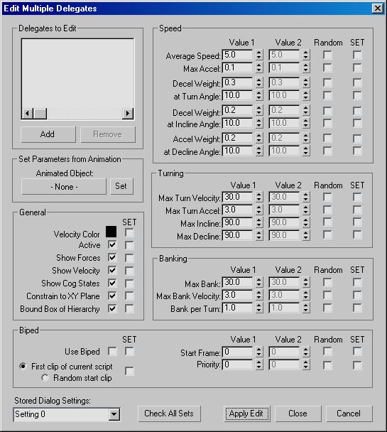

The Edit Multiple Delegates dialog lets you define groups of delegates and set parameters for them. You can create and store up to 10 different configurations or settings combinations; each consists of one or more delegates and settings for the delegates.
The parameters are mostly the same as those found in the delegate object's Motion Parameters rollout, with the following exceptions and additions:
- Each setting has an associated SET checkbox, which lets you determine whether the setting has any effect. When off (the default), the setting has no effect. When on, the setting affects the specified delegate or delegates when you click the Apply Edit button.
- Each numeric parameter has two Value settings and an associated Random checkbox, which lets you specify a random value within a specified range for each member of the group. By default, Random is off, and the Value 1 setting is applied for all parameters with SET turned on. If you turn on Random for a parameter, its Value 2 setting becomes available. If you then specify a different setting for Value 2, character studio calculates a different random number between Value 1 and Value 2 for each delegate in the group.

To edit multiple delegates:
Select the Crowd object and go to the
Modify panel. - On the Setup rollout, click
(Multiple Delegate Editing). This opens the Edit Multiple Delegates dialog.
- Optionally, in the dialog (bottom-left corner), choose a stored dialog setting to use from the 10 available settings.
- If necessary, use the Delegates To Edit group box controls to add delegates to or remove them from the current setting.
- Modify the remaining parameters as necessary. Be sure to turn on the SET checkbox for any parameters that are to change.
- Click the Apply Edit button to make the changes and exit the dialog.

Delegates to Edit group
- [list of delegates]
- Shows delegates that belong to the current settings combination.
- Add
- Click this button, and then choose delegates to add from the Select dialog.
- Remove
- To remove delegates from the list, first choose the names of those to delete in the list box (drag to choose two or more contiguous names, or use Ctrl-click to choose non-contiguous names), and then click Remove.
Set Parameters from Animation group
Use this function to obtain motion parameters from an animated object and apply them to all specified delegates. It affects only Average Speed, Max Accel, and the Turning parameters.
Because this one animation will set most of the parameters of the delegate, it should be representative of a whole range of motion of the delegate. For example, the object should turn and accelerate. The animation should be somewhat lengthy so that averages are calculated correctly.
- Animated Object
- Specifies an animated object. Click this button, and then choose the object from the list in the Select dialog.
- Set
- After specifying the animated object, click this button to apply its parameters to the delegate settings. Also turns on the SET checkbox for any affected parameters.
General group
Rather than numeric values, the settings in this group are on-off switches, except for the first, Velocity Color. To change Velocity Color, click the color swatch, use the Color Selector dialog to pick a new color, and then turn on the Velocity Color SET checkbox. To change any other setting in the General group, click the checkbox to the right of the setting, and then turn on the setting's SET checkbox.
These settings are the same as those found in the delegate object's Motion Parameters rollout.

- Stored Dialog Settings
- Use this list to specify up to 10 different combinations of delegates and settings. To store a combination, choose a name from the list, and then specify the delegates and settings. To recall a combination, choose its name from the list. To rename a combination, choose its name from the list, and then highlight the name and edit it using the keyboard.
- Check All Sets
- Click this button to turn on all SET checkboxes. This ensures that any changes you make in the dialog take effect when you click the Apply Edit button.
- Apply Edit
- Click Apply Edit to implement all changed settings and exit the dialog.
- Close
- Click Close to remember, but not implement, all changed settings and exit the dialog.
- Cancel
- Click Cancel to forget all changed settings and exit the dialog.
