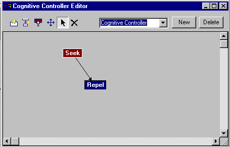

The editor interface consists of an icon-based toolbar above a window that contains the state diagram. When you first open the editor, no state diagrams exist. Begin by clicking the New button to create a new state diagram.
Interface
Create State-
Lets you create new states in the diagram. Click this button, and then click in the state diagram area to add states. A state appears as a rectangular box containing the name of the state.
The first state you add is, by default, the first state in the controller that executes when the simulation is run. This is indicated by its red color; states you add subsequently are colored blue. To set a different state to execute first, use the Set Start State function.
You specify a state's name and behaviors by editing the state. To edit a state, right-click it. This opens the State Dialog.
Create Transition-
Lets you link states with transitions. Click this button, and then drag between two states to create the transition, starting with the earlier state. The transition appears as a black arrow pointing from the first state to the second. Alternatively, if you click a state with the Create Transition tool active, you create a transition that loops back to the state itself.
Right-click a transition to specify its characteristics and conditions by editing the transition. This opens the State Transition Dialog.
Set Start State-
Normally the state that executes first in a cognitive controller is the one that was added first. Use this tool to choose a different state to execute first. The start state is red; the rest are blue.
Typically you would use this when you have a circular sequence of states, and you want to change which state executes initially.
Move State-
Lets you move states around in the window by dragging them.
Select State/Transition-
Lets you select states and transitions for subsequent deletion. Selected states have white outlines, and selected transition lines are white.
You can select multiple states by dragging a box around them. You can select multiple states and transitions by holding the Ctrl key as you click.
Delete State/Transition-
Lets you delete one or more states or transitions. First select any combination of states and transitions to delete, and then click this button.
- (Name)
Shows the name of the current state diagram. To display and/or edit another, choose it from the list.
To change a state diagram's name, click the name in the box and use the keyboard to edit the text.
- New
Adds a new cognitive controller. By default, cognitive controllers are named “Cognitive Controller” followed by a number, but you can change this to anything you like.
- Delete
Deletes the current cognitive controller. This is an undoable operation.
