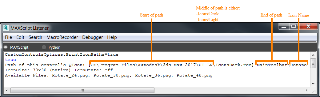

- Open the MAXScript Listener window.
- Select MAXScript.
- In the output (white) pane, type
CustomControlsOptions.PrintIconPaths=true.
The word True appears in blue below your text.
- Move the cursor over the icon you want to change.
The icon's location path, size, state, and available files appear in MAXScript Listener.
Tip: Move the mouse carefully as any icon the mouse passes over will be listed. This may become confusing if too many icons are listed.
- Take note of the icon's path and name.

- In the Light/Dark folder, create a folder for the end of the path and copy your appropriately named SVG or PNG file(s) therein.
Note: The PNG files must follow the nomenclature of either IconName.png or IconName_Size.png.
For the example above, if providing several icon sizes, the complete icon path would be C:\Program Files\Autodesk\3ds Max 2017\UI_LN\Icons\Dark\MainToolbar. The icon file would be called Rotate.png (and/or Rotate_24.png, Rotate_30.png, etc.).
