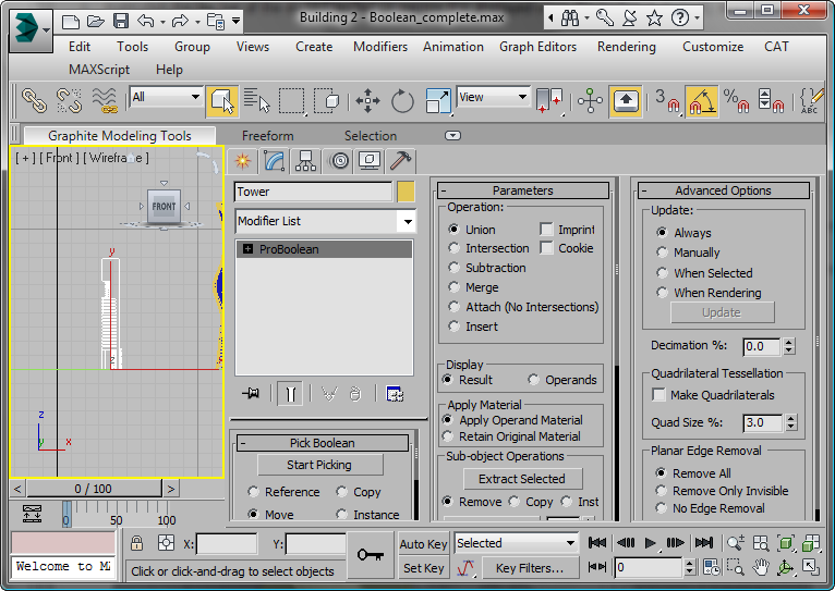

To resize the command panel in its docked location, drag its edge to the left or right:
Multiple command panel columns are useful when working with objects such as ProBoolean or PFlow, which have many controls.
