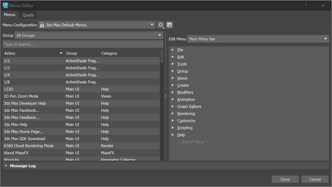

The Menu Editor lets you customize 3ds Max menus and quad menus.
  • Default menu: Customize menu > Menu Editor
The Menu Editor displays the currently loaded menu and quad menu configurations, and lets you customize them by adding or removing menu items. Customized configurations are stored in .mnx files (for menus) and .qmnx files (for quad menus). These files can be copied and used in later versions of 3ds Max to preserve your customizations.
On this dialog you can:
  • Load or save menu and quad menu configurations.
  • See where menu actions are used in the currently active menu and quad menu configuration, and find the action associated with a specific menu or quad menu item.
  • Edit macroscripts that define menu actions.
  • Create, rename, move, or delete menus, quad menus, menu separators, and menu items.
  • Flatten sub-menus (move sub-menu items up to the menu level).
  • In Developer Mode, you can create new top-level menus and quad menus for use in a plug-in, and create translation files for those configurations.

Interface
Menus Tab
Menu Configuration
Lets you choose the menu configuration to edit.
Group
Action items are organized into groups related to their feature area. This drop-down lets you specify which group of action items to look at.
Search Field
Lets you filter the list of action items by keyword.
Action List
Lists action items by name, and including their group and category, where assigned. From this list you can right-click items to see where they are used in the menu tree, and to edit their underlying macroscripts. You can also drag items from this list into the menu structure on the right to create a new menu item.
Edit Menu
Lets you select a menu to edit.
Menu Tree
Provides a tree view of sub-menus and menu items in the menu selected in the Edit Menu list.
