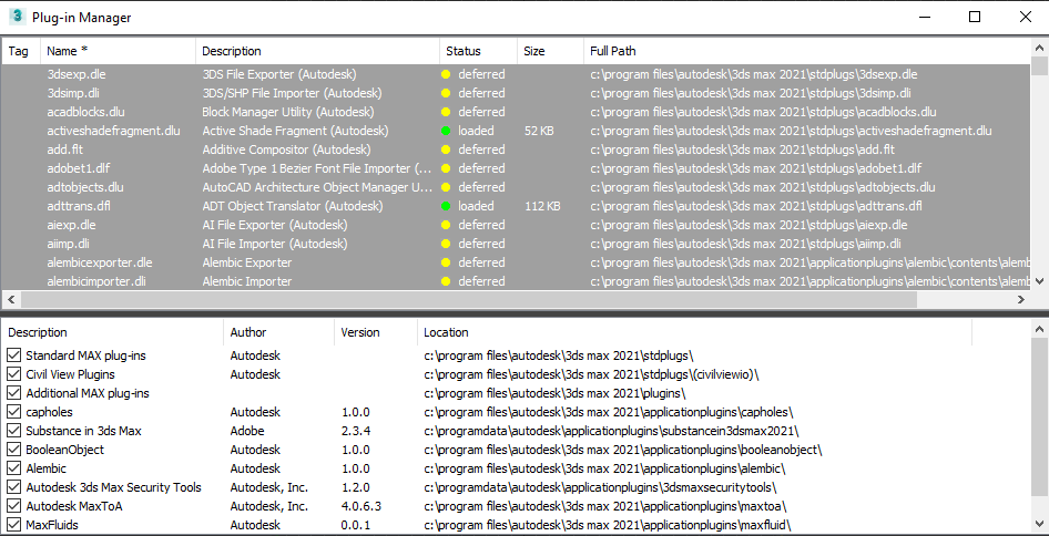

The Plug-in Manager lets you manage plug-ins. The Plug-in Manager provides a list of all plug-ins found in the 3ds Max plug-in directories, including the plug-in description, type (object, helper, modifier, and so on), status (loaded or deferred), size, and path. The Plug-in Manager provides options to load any plug-in, regardless where it resides on disk. Unlike the File Properties dialog, which only lists plug-ins used in a scene, the Plug-in manager lists all loaded plug-ins, and allows you to manage them.
Interface
When you start the Plug-in Manager, it scans through all the loaded plug-ins (from the location listed at the bottom of the dialog) and lists them. Note that the Plug-in Manager does not list scripted plug-ins, nor .NET plug-ins, only C++ plug-ins. The information is divided up into columns as described following.

Plug-in Directories and Plug-in Packages
3ds Max loads plug-ins from several locations.
The Plug-in Manager uses the plug-in directories listed in plugin.ini, Plugin.UserSettings.ini, and the default plug-in bundle paths (the location where Autodesk App Store plug-ins are installed). It also displays the directories for plug-in packages that have been loaded by 3ds Max.
You cannot configure paths in the Plug-in Manager, but you can configure some of these paths with the 3rd Party Plug-Ins Path Configuration tab of the Configure User Paths dialog. You can display or hide all the plug-ins in a directory by toggling its checkbox.
