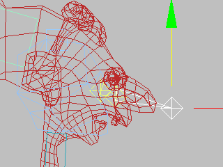

To add a bone after Physique is applied using Reinitialize:
- Turn on
(Figure Mode). - Add a bone where it is needed.
Link the root node of the bone to the biped. - On the Physique rollout, click
(Reinitialize). - On the Physique Initialization dialog, click Initial Skeleton Pose and then click Include New Bones.
Vertex Link Assignment turns on also.
- Click Initialize.
- Adjust envelopes in Sub-Object Envelope.
- Turn off
(Figure Mode). If you want the end of the bone to follow the biped, select the bone and delete the bone end effector in the Motion Panel
This bone is used to animate the character's nose.
