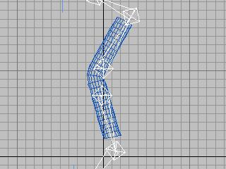

The skeleton to which you attach a skin using Physique can be a 3ds Max hierarchy, bones in a hierarchy, bones not in a hierarchy, or splines. Physique deforms the skin based on the relative position of the bone or links in the hierarchy. Specifically, it uses the length of each link and the angle between two connected links; it can also use the scale of a link.
The skeleton hierarchy can also be a 3ds Max system object that defines a behavior as well as a hierarchy. There are two kinds of objects that are especially useful with Physique:
- Bones are a standard Systems object provided with 3ds Max. Bones can either be hierarchically linked or floating.
- Splines can be used rather than a “bones” hierarchy.

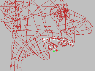

Spline-Based Physique Deformation
In addition to the biped and 3ds Max bones, Physique supports spline and NURBS curves for mesh deformation. By animating vertices on a spline, you can animate the mesh. You can use this technique for facial animation or to deform any mesh.
To control a mesh with a spline:
- Place a spline inside a mesh.
Select the mesh and apply the Physique modifier. - In the Physique
Floating Bones rollout, click Add and in a viewport, pick the spline. -
Select the spline, go to the Vertex sub-object level, and
move the spline vertices to animate the mesh.
