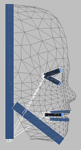

You can use Physique for facial animation, as an alternative to morphing. To do so, you must set up the face of a character with extra links. By setting up 3ds Max bones or other objects at appropriate locations on the mesh head, you can define a skeletal structure for moving the facial features.
Boxes form the facial skeletal structure.

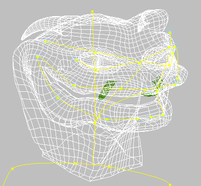

You can also use splines linked to the biped head to deform the mesh. You can add a spline to a character that already has Physique applied by using Add in the Physique Bones rollout and clicking the spline in a viewport.
Splines used for detailed facial animation.
Facial Bone Structure
A common skeletal structure for the face includes:
- Bones to make the upper and lower lips open and close.
- Bones to push the outer corners of the mouth, as for a smile.
- Bones to make the eyes open and close.
- A bone to control the jaw opening and closing.
- The main head bone going straight up from the neck to the top of the head. This bone controls the head overall, and any vertices not affected by bones on the eyes, mouth and jaw. Use this bone to bend the head forward or backward.

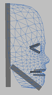

In general, the lower lip bones should be linked to the jaw, and upper lip, jaw and eye bones should be linked to the main head bone.
Facial bone linkage

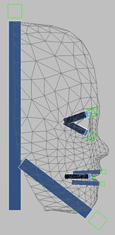

If you use objects other than 3ds Max bones, you must create dummy objects at the end of each object used as a bone, and link each one to its corresponding bone before applying Physique. This is necessary because Physique extends links to the end of the second-to-last object in the hierarchy, not the last. In other words, if you don't create and link the dummy objects to the bones, Physique will not extend links to the ends of the bones.
Dummy objects at ends of bones

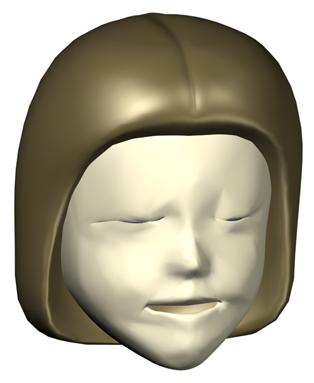

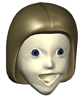

Facial expressions animated with Physique and facial bones.
You can perform lip synch animation by loading a sound track in Track View. By scrubbing the time slider, you can locate a sound and keyframe the dummies to appropriate positions.
