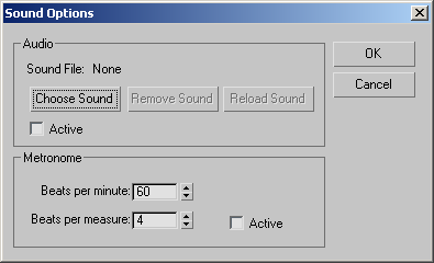

To add a Default Sound track:
  1. Make sure the Default Sound plug-in is active (see Note, preceding).
  2. In the Track View Controller window, highlight the Sound track.
    Tip: The Sound track does not appear in Track View by default. To unhide it, open the Filters dialog and, in the Show group, turn on both Sound and Global Tracks.
  3. Right-click the Sound track and choose Properties.
    3ds Max opens the Sound Options dialog.
  4. Click Choose Sound, select a sound file, and then click OK.
    A Wave Form branch appears in the Track View Hierarchy. A waveform appears in the Track View Key window.
  5. Turn on Real Time in the Time Configuration dialog to hear the sound track when you play your animation.
Interface
Audio group
Choose Sound
Displays a file selector where you choose a sound file.
Remove Sound
Deletes the waveform from Track View.
Reload Sound
Reloads the last loaded file. This allows the sound file to be reloaded when it has been changed by another program.
Active
Plays the waveform during animation play back.
Metronome group
The Metronome track produces a regular beat using two tones. You specify three settings in the Sound Options dialog to control the Metronome:
Beats per minute
Sets the frequency of beats. The beats display in the Metronome tracks as black vertical bars. Default=60.
Beats per measure
Sets which beat is emphasized with a higher pitch tone. Emphasized beats display in the Metronome track as black pluses. For example, a setting of 4 generates a higher pitched tone every fourth beat. Default=4.
Active
Plays the beats during animation playback.
