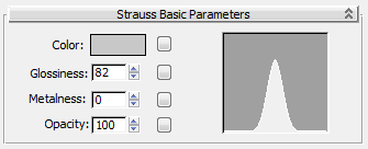

Interface
- Color
Controls the color of the material. This corresponds to the diffuse color you specify for other kinds of shaders. With the Strauss shader, you control only this color. The shader calculates the ambient and specular color components.
Click the map button to assign a Diffuse Color map. This button is a shortcut: You can also assign a Diffuse Color map on the Maps rollout.
- Glossiness
Affects the size and intensity of the specular highlight. As you increase the value, the highlight gets smaller and the material appears shinier. Default=25.
Glossiness also controls the strength of reflection maps assigned to a Strauss material.
Click the map button to use . This button is a shortcut: You can also assign a Glossiness map on the Maps rollout.
- Metalness
Changes the metallic appearance of a material. Increasing the Metalness value increases the metallic appearance, with glancing as well as primary highlights. Because a metallic appearance principally depends on highlights, the Metalness value has little effect unless you also increase the Glossiness value. Default=0.
Tip: When you create a metal material, make sure the backlight is on in the sample slot or Preview window.Click the map button to assign a map. This button is a shortcut: You can also assign a Metalness map on the Maps rollout.
- Opacity
Sets the opacity/transparency of the material as a percentage. The effect is best previewed against a pattern background in the sample slot. You can control opacity falloff in the Extended Parameters. Default=100.
Click the map button to assign a map to the Opacity component. See Opacity Map. This button is a shortcut: You can also assign an Opacity map on the Maps rollout.
- Highlight graph
This curve shows the effect of adjusting the value of Glossiness. As you decrease Glossiness, the curve grows shorter; as you increase it, the curve grows taller.
