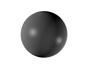

The Oren-Nayar-Blinn shader is a variant of the Blinn shader. It contains additional "advanced diffuse" controls, Diffuse Level and Roughness, that you can use to give the material a matte effect. This shader is good for matte surfaces such as fabric, terra cotta, and so on.
Oren-Nayar-Blinn shading typically has a matte appearance.
