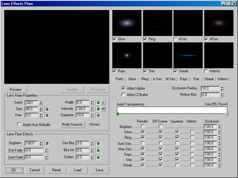

Interface
[preview group]
The large black window in the left corner is the main preview window. To the right of this window are smaller preview windows for each part of the flare. You can generate continual previews by clicking the Preview button under the main preview window.
There are nine Lens Effects Flare preview windows. The main preview window in the upper left corner of the Lens Effects dialog shows you the complete scene. The eight smaller preview windows in the upper right corner show the individual parts of the lens flare. Each small preview window has a checkbox below the window to display the flare effect.
You might notice that an individual part of the lens flare effect might not appear as bright in the smaller preview windows, compared to the main preview. This is because the brightness of a lens flare in the main preview is a result of combining the brightness of multiple effects, the total brightness being greater than a single part.
All of the preview windows are multi-threaded to increase redraw speed and take advantage of multi-processor systems. When you make an adjustment to a lens flare property and the preview window is active, the preview updates automatically. A white line at the bottom of the main preview window indicates that it is updating a change made within the lens flare dialog.

Lens Flare Properties group
Specifies global settings for the flare, such as the source for the flare(s), the size, seed number, rotation, and so on.

Flare Parameter tabs
Let you create and control the lens flare. Each of the nine tabs controls a specific aspect of the lens flare.
A flare is composed of eight basic parts. Each part of a flare is controlled on its own panel in the Lens Effects Flare interface. Each part of the lens flare can be individually activated and deactivated to create different effects.
Prefs: This page lets you control which parts of a lens flare are active and how they effect the overall image.
Glow: A general glow centered around the source object of the flare. You can control the color, size, shape, and other aspects of the glow.
Ring: A circular color band that surrounds the center of the source object. You can control the color, size, shape, and other aspects of the ring.
A Sec: Auto Secondary Flares. The small circles you would normally see coming out from the source of the lens flare. As the camera position changes relative to the source object, the secondary flares move. The secondary flares are automatically generated when this option is active.
M Sec: Manual Secondary Flares. Additional secondary flares added to the lens flare effect. They appear in the same axis as the automatic secondary flares and look very similar.
Rays: Bright lines that radiate out from the center of the source object, providing the illusion of extreme brightness for the object.
Star: Bright lines that radiate out from the center of the source object, generally composed of 6 or more spokes, (instead of hundreds, like a ray). Stars are generally thicker and extend out farther from the center of the source object than rays.
Streak: Wide horizontal bands that run through the center of the source object.
Inferno: Lets you add special effects, such as explosions, to your flare effect.
