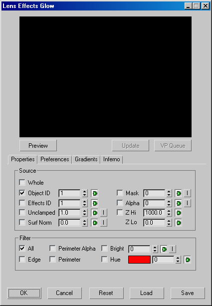

The Lens Effects Glow dialog contains a preview window, and an area below to control the parameters of Glow.
[preview group]
[preview window]
Lets you quickly preview the glow effect. The preview window is multi-threaded to take advantage of systems with multiprocessors, and updates every time you make a change to any of the glow settings that might affect the scene.
Preview
Displays a generic scene to which you can quickly set up a Glow effect. Appears light green when selected.
VP Queue
Lets you preview the scene in the Video Post queue. Preview must be selected for the VP Queue function to work.
[Glow control tabs]
The Lens Effect Glow dialog contains four tabs: Properties, Preferences, Gradients, and Inferno
Reset
Resets Lens Effects Glow to its default settings.
Load
Displays a Windows-standard file open dialog from which you can select the settings file you want to load.
Save
Displays a Windows-standard Save As dialog in which you specify a directory and filename. Lens Effects Glow settings are saved as LZG files.
