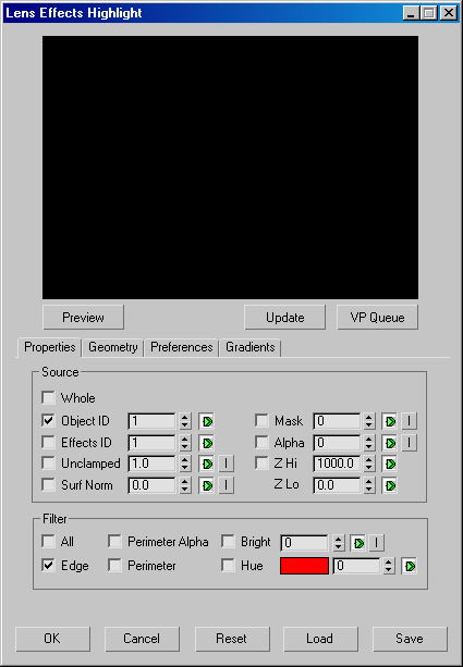

Interface
When you select Lens Effects Highlight from the Image Filter Event drop-down list and click Setup, 3ds Max opens the Highlight dialog.
The Lens Effects Highlight interface is almost identical to the Glow interface, with a large preview window, and tabs to control every aspect of your highlight effects.
[preview group]
[preview window]
Lets you quickly preview the glow effect. The preview window is multi-threaded to take advantage of systems with multiprocessors, and updates every time you make a change to any of the glow settings that might affect the scene.
Preview
Activates a generic cross star filter so you can quickly set up a Highlight effect. However, as with the Glow module, it is more effective seeing your entire scene and how your effect will interact with your geometry.
VP Queue
Lets you preview the scene in the Video Post queue. Preview must be selected for the VP Queue function to work.
