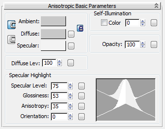

The Basic Parameters rollouts for Standard materials contain controls that let you set the color of your material, the shininess, the transparency, and so on, and specify maps to use for the various components of the material.
Example: The Basic Parameters rollout for the Anisotropic shader.
Basic Parameters rollouts vary depending on which shader is chosen.
The Basic Parameters rollout changes depending on which kind of shader you choose in the Shader Basic Parameters.
