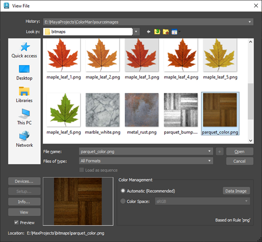

View File Dialog
Choose and view still images, numbered image sequences, images in an IFL file, or animation files using options in the View File dialog. Still images and numbered image sequences appear in a feature-reduced version of the Rendered Frame Window.

Look In
Browses drives and directories.
Go To Last Folder Visited
Click to return to the folder you previously browsed to.
Up One Level
Moves you up a level in the directory structure.
Create New Folder
Lets you create a new folder while in this dialog.
View Menu
Provides several options for how information is displayed in the list window:
  • Thumbnails: Displays the contents of a directory as thumbnails, without the details.
  • Tiles: Displays the contents of a directory as large icons, without the details. If you widen the dialog, these tile across the width.
  • Small Icons: Displays the contents of a directory as small icons, tiled across the width, without the details.
  • List: Displays the contents of a directory without the details.
  • Details: Displays the contents of a directory with full details such as size and date.
[list of files]
Lists the contents of the directory, in the format specified by the View menu.
Tip: When View Menu Details is chosen, the contents of the directory are displayed with Name, Size, Type, Date Modified, and Attributes. You can sort the list according to a column's contents by clicking that column's label.
File Name
Displays the name of the selected file.
Files of type
Selects the type of files to list in the directory window.
Load as sequence
This is unavailable in the View File dialog.
Devices
Lets you choose the hardware output device, for example, a digital video recorder. To use the output device, the device, along with its driver, and its plug-in must all be installed on your system.
Setup
Info
Displays expanded information about the file, such as frame rate, compression quality, file size, and resolution. The information here depends on the type of information that is saved with the file type.
If the file has an embedded value, this dialog displays that value. Otherwise, it displays "N/A".
View
View the selected image or animation.
Preview
Toggles the image preview display.
[preview thumbnail]
Displays a preview of the selected image.
