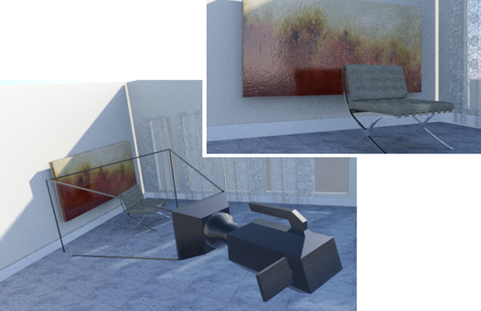

Create Physical Camera From View creates a Physical camera whose field of view matches an active Perspective viewport. At the same time, it changes the viewport to a Camera viewport for the new camera object, and makes the new camera the current selection.
Note: Create Physical Camera From View is available only when a Perspective viewport is active.
Inset: Perspective view of a scene
Main image: Physical camera created so as to frame the Perspective view
