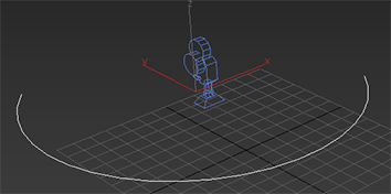

Move a Camera Along a Path
Having a camera follow a path is a common way to create architectural walkthroughs, roller coaster rides, and so on.
  • If the camera must bank or tilt close to the vertical (as on a roller coaster), use a free camera. Assign the Path constraint directly to the camera object. The camera follows the path, and you can adjust its point of view by adding pans or rotate transforms. This is comparable to filming with a hand-held camera.
  • For a target camera, link both the camera and its target to a dummy object, then assign the path constraint to the dummy object. This is comparable to mounting the camera on a tripod on a dolly. It is easier to manage than having, for example, separate paths for the camera and its target.

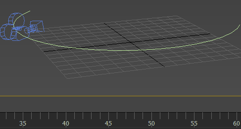

Animate a Camera along a path

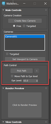

You can create a path for the camera to follow using the Walkthrough Assistant.
  1. Add a camera to the scene. (Create > Cameras > Free Camera).
  2. Create a path in the scene using a spline shape or a NURBS curve (Create > Shapes > Arc).
    Note:
    • Text and Section are not recommend shapes for creating a camera path.
    • Create smoother camera movement by setting the spline shape Creation Method Smooth or Bezier instead of Corner.
  3. Open the Walkthrough Assistant. Default menu: Animation menu > Walkthrough Assistant > Advanced Controls rollout. (Alt menu: Animation menu > Tools (Animation Set) > Walkthrough Assistant > Advanced Controls rollout. In the Path Control group, click Pick Path, then click the path you created. The camera snaps to the path you created.
  4. Rotate the Camera to face the direction you want.
  5. Click Play or scrub the time slider to see the camera move along the path.
