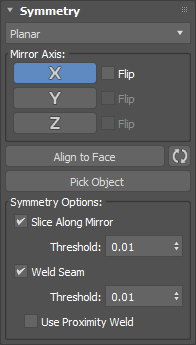

Parameters rollout
- Symmetry Type menu
- Choose the slice type, either Planar or Radial.
Mirror Axis group
- X, Y, Z buttons
- Mirrors the object along the selected axes.
Note: X is the default axis.
- Flip (Planar type only)
- When enabled, flips the symmetry to the opposite side of the corresponding axis.
- Align to Face button
- Selects the face used to align the gizmo.
Reset Gizmo button
- Resets the gizmo to its default position.
- Pick Object button
- Selects a reference object from the scene.
Symmetry Options group
- Count (Radial type only)
- Sets the radius of the symmetry.
- Mirror Symmetry (Radial type only)
- When enabled, mirrors half of the geometry to generate clean seams.
- Flip (Radial type only)
- When enabled, flips the mirrored half of the geometry to the opposite side.
Mirror Symmetry with Flip option enabled and disabled
- Slice Along Mirror
- When enabled, causes the mirror gizmo to act as a slice plane when located inside the boundaries of a mesh. When the gizmo is outside the boundaries of a mesh, the symmetrical reflection is still treated as part of the originating mesh. If Slice Along Mirror is disabled, the symmetrical reflection is treated as a separate element of the originating mesh. You can also adjust the Threshold spinner to control the distance of the welded vertices when the mesh is cut. Default=on.
- Weld Seam
- When enabled, automatically welds the vertices along the mirror axis. You can also adjust the Threshold spinner to control the distance of the welded vertices when the mesh is cut. Default=on.
- Proximity Weld
- When enabled, Proximity Weld uses the old method of welding vertices based on proximity. Whereas, the new default method keeps track of the vertices that are generated from the cutting and welds them in a smarter way. Default=off.
