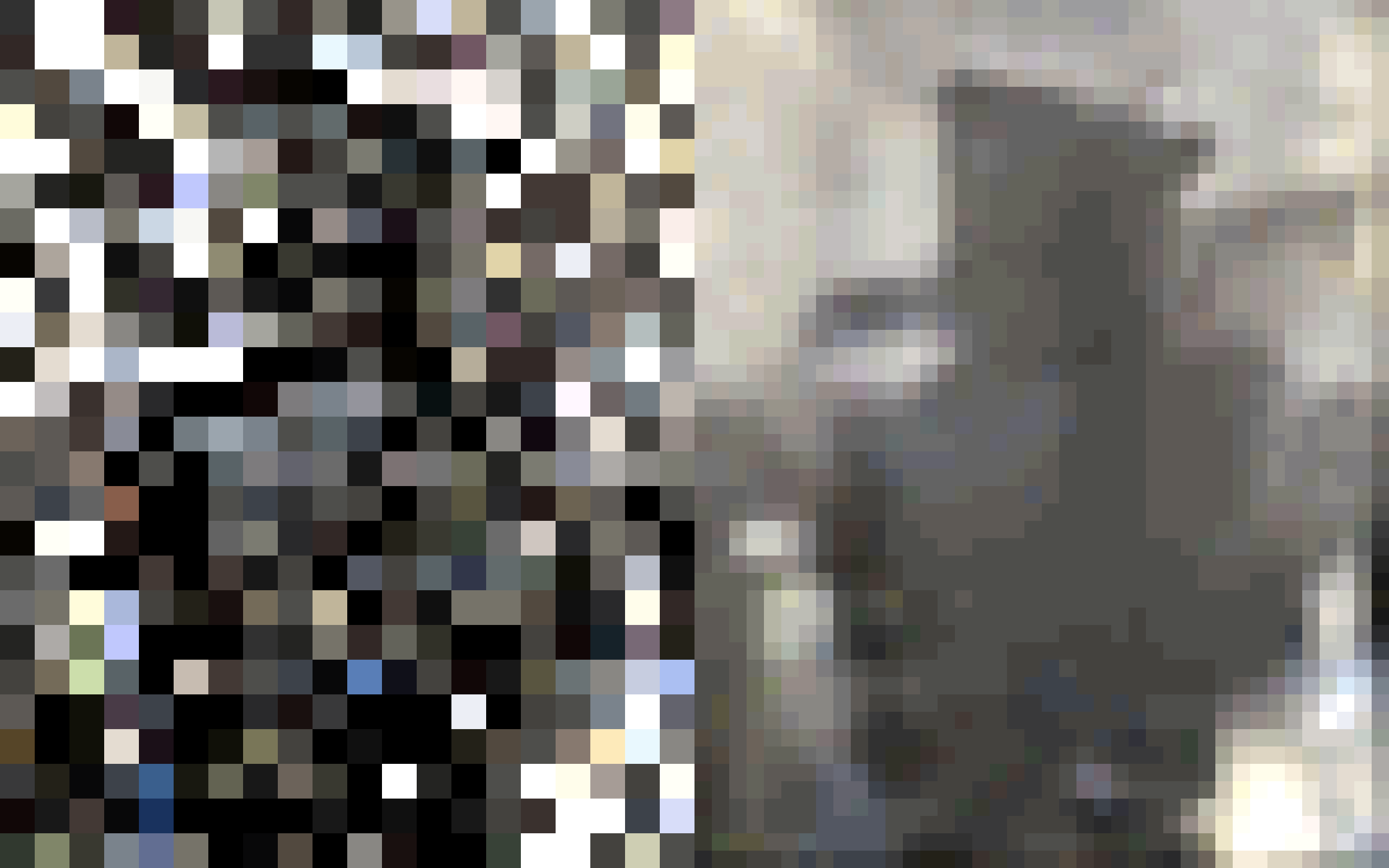

Denoising by default with Intel® Open Image Denoise (OIDN)
The Intel® Open Image Denoiser imager is now added by default to new scenes (MTOA-1787)
| without denoising | with _imager_denoiser_oidn |

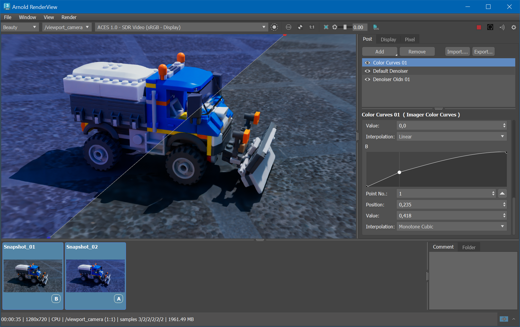

Arnold RenderView updated
Arnold RenderView (ARV) has new snapshot functionality and other polish. (MAXTOA-1727)
Arnold RenderView is now dockable
The Arnold RenderView window (ARV) is now dockable by default, and follows the behavior of other dockable windows. If this is not desired, it can be turned off in the MAXtoA render settings. (MAXTOA-1722)

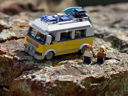

- Update Intel® Open Image Denoise (OIDN) to version 2.2.2: The updated denoiser has 10% better performance on CPU, includes some critical bug fixes, and handles high-frequency details better. (ARNOLD-14772)

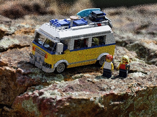

- OptiX denoiser runs on progressive negative AA passes: The OptiX denoiser imager now denoises the low-resolution progressive passes (renders with AA < 0). This should result in higher quality feedback in IPR. (ARNOLD-11487)
Left side shows the previous behaviour where denoising was only applied to the AA > 0 passes. Right side is new behaviour where all progressive passes are denoised.
