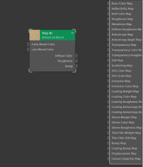

Screenshot of the navigator window in the slate material editor
The Navigator centered on nodes in the View

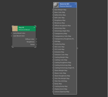

Screenshot of the view window in the slate material editor
The corresponding appearance of the active View
The rectangle in the Navigator shows the border of the active View. Dragging the rectangle in the Navigator changes the focus of the View.
