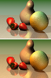

Above: Color balance effect used to correct the color cast.
Below: Original rendering has a yellow cast.

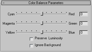

The Color Balance Parameters rollout contains the following parameters:
Cyan/Red
Adjusts the red channel.
Magenta/Green
Adjusts the green channel.
Yellow/Blue
Adjusts the blue channel.
Preserve Luminosity
When on, retains the luminosity of the image while correcting the color.
Ignore Background
When on, allows you to image correct a model without affecting the background.
