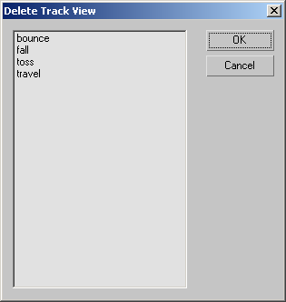

Delete Track View displays the Delete Track View dialog, which lets you delete one or more stored Track View windows.
Procedures
To delete a Track View window:
- From the Graph Editors menu, choose Delete Track View.
3ds Max opens the Delete Track View dialog.
- In the Delete Track View dialog, highlight the name of one or more Track View windows.
- Click OK to delete the Track View windows you chose.
Interface
Drag a selection, use Shift+click to select additional contiguous Track View windows, or Ctrl+click to select or deselect individual (noncontiguous) windows.
