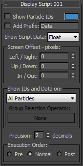

Interface
- Show Particle IDs
- When on, each particle's unique index number is visible in the viewports. Particles are numbered in the order of their birth, starting with 1 for the first particle born.
- [color swatch]
- Shows the color used to display the data. The software chooses a different color at random for each Display Script operator added to the system. To change the color, click the color swatch and use the Color Selector dialog to choose a new color. Note: If the emitter is selected, the data is displayed in white.
- Add Prefix
- When on, displays the text from the edit box to the right of the check box to the left of the data in the viewports.
To specify the prefix text, click in the box to the right of Add Prefix and enter the text from the keyboard. It's not necessary to append the text with a space; the operator automatically offsets the prefix from the data.
- Show Script Data
- Choose the type of script data to show in the viewports. The available choices are: Float, Integer, Vector X, Vector Y, Vector Z, and Vector.

- Screen Offset group
- - Use these values to adjust the positioning of the script data relative to the particle position, in pixels. By using different offset values and several Script and Display Script operators, you can show multiple data at once (Position, Speed, Scale, etc.).
- Show IDs and Data on
- Lets you filter the particles for data display. The options are:
- All Particles Displays data for all particles in the viewports.
- Selected Particles Only Displays data only for selected particles. To select particles, use the Modify panel > Selection rollout controls and use standard viewport selection methods to pick particles to see their data.
- Group Selected Only Displays data for group-selected particles only. Use the Group Selection Operator button to specify the applicable operator; this can be a Group Selection or Camera Culling operator. Tip: With the Camera Culling operator, you can show only data for particles that are visible to the camera.
- Group Selection Operator
- Sets the Group Selection operator for the Group Selected Only option (see above). Click this button (labeled "None" by default) and then use the dialog that opens to choose a Group Selection or Camera Culling operator. Thereafter the operator name appears on the button.
- Precision
- Sets the number of decimal places displayed in float fields. Range=0 to 8 (where 0 means no decimal places).
