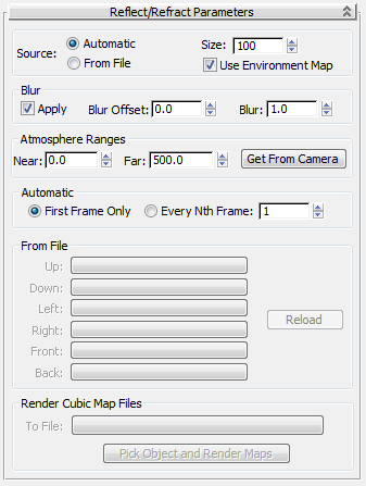

Interface
- Source
Chooses the source of the six cubic maps.
- Automatic Automatically generates by looking out in six directions from the pivot of the object with the material, then mapped onto the surface during rendering. When on, the options in the Automatic group are active, letting you choose whether the maps will be generated only once, or regenerated at specified frames in the animation.
- From File When on, you can specify the bitmaps to use.
When From File is active, the controls in the Render Cubic Map Files group are also available. You can generate the six cubic reflection maps automatically and save them to files, where you can load them with the From Files controls.
- Size
- Sets the size of the Reflect/Refract maps. The default value of 100 produces distinct images. Lower values lose progressively more detail.
- Use Environment Map
- When off, environment maps are ignored by Reflect/Refract map during rendering. It's useful to turn this off when you have mirrors in the scene and you're rotoscoping against a flat screen environment map. A screen environment map does not exist in 3D space the way the other environment-map types do, and will not render properly. Default=on.
Blur group
- Apply
- Turns on filtering to blur the maps.
- Blur Offset
- Affects the sharpness or blurriness of the map without regard to its distance from the object. Use Blur Offset when you want to soften or defocus the details in a map to achieve the effect of a blurred image.
- Blur
- Affects the sharpness or blurriness of the generated map based on its distance from the object. The farther away the map is, the greater the blurring. Blur is primarily used to avoid aliasing. It's a good idea to use a small amount of blurring for all maps in order to avoid the scintillation or aliasing that can occur when pixel details are reduced off in the distance. Default=1.
Atmosphere Ranges group
If your scene contains environmental Fog, the cubic maps must have near and far range settings to properly render the fog from the point of view of the object assigned the material. The Near and Far spinners in this group let you specify a fog range relative to the object.
- Near
- Sets the near range for fog.
- Far
- Sets the far range for fog.
- Get From Camera
- Uses the Near and Far atmosphere range settings of a camera in the scene. Click this option, and then select the camera.
These values aren't dynamically linked to the camera object. They are simply copied from the camera's range values at the time you click the camera. If the camera's range values later change, the map's Near and Far values remain the same.
Automatic group
This controls are active only when Automatic is the active source for the Reflect/Refract maps.
- First Frame Only Tells the renderer to create automatic maps only on the first frame.
- Every Nth Frame Tells the renderer to create animated auto maps based on the frame rate set by the spinner.
From File group
These controls are active when From File is active as the Reflect/Refract source. Here you assign the six bitmaps to be used as the cubic maps.
- Up / Down / Left / Right / Front / Back
- Assigns one of the six cubic maps. If the map is one of a set of six with the correct file name, all six are loaded.
If the map doesn't follow file naming conventions, or you assign it to a button of a different position (_UP to Front, for example), only that map is assigned. You must assign the others manually.
- Reload
- Reloads the assigned maps and updates the sample slot.
You can edit one or more of the cubic maps using a paint program, then click Reload to update the material and the scene.
- To File
- Choose a file name for the Up map ( _UP).
- Pick Object and Render Maps
- Active when you choose a file. Click to turn on, then select the mapped object to render the six cubic maps. Assign the cubic maps to the six From File buttons.
