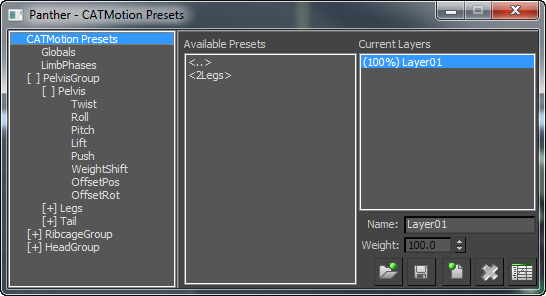

- Available Presets
This list shows the CATRig presets in the current folder. You can navigate up to other folders by double-clicking the <..> symbol at the top of the list.
- Current Layers
This list shows the currently loaded layers/presets of your CATMotion layer. If the Current Layers list contains multiple layers, you can view and edit a layer/preset by clicking on it, so the curves for that layer/preset will be active in the CATMotion hierarchy, ready for editing.
Note: The advantage of having multiple layers in the Current Layers list within a single CATMotion layer is that you can blend seamlessly between different walk cycles while still controlling the whole walk sequence with a single set of footprints. This means you have non-sliding footsteps even while blending between different walk cycles (for example, walk/run/sneak). If you used multiple CATMotion layers in the Layer Manager instead, blending between the CATMotion layers would result in sliding footsteps and a lot of unnecessary footprints. - Name
The name of the highlighted layer.
- Weight
The weight of the highlighted layer.
Open CATMotion Preset -
Click to browse for a preset.
Save CATMotion Preset -
Save the settings of the highlighted CATMotion layer as a new preset.
Add CATMotion Layer -
Create a new default CATMotion layer to edit.
Delete CATMotion Layer -
Delete the highlighted layer.
Curve Editor: CATMotion Weights -
Edit CATMotion Layer Weights in Track View.
Use this function to edit the animation of preset weights, blending between presets.
